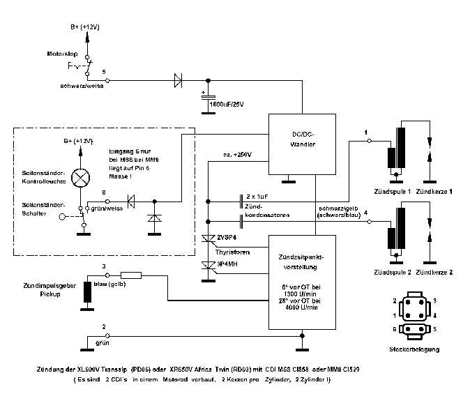

MM9 CI529
Arnold Neugebauer hat Gerd Walter's MM9-008-CDI seziert und die Schaltung analysiert - dies sind die Ergebnisse und die sind nur was für echte Fachleute ;-).
Für eine MM8-610 findet ihr die Daten weiter unten, für die MM9-830 steht die Aktion noch aus. Das kriegen wir aber auch noch hin.....;-)
Vielleicht kann ja jetzt jemand eine Zündbox selbst bauen oder in einer günstigen Kleinserie herstellen ... :
This is the layout and schematic of a Honda Transalp CDI marked MM9 CI529. I've also added oscilloscope screenshots of some selected points. These double CDIs have been built in some variants until 1995, I think (from year 1996, the CDI is a single unit and has completely changed).
The contents of the black box is not surprising. It's a standard capacitive discharge ignition like the name implies. Only the double thyristor stage is somewhat unusual. A DC-DC-Converter generates about 18 V for the signal conditioning stages and about 250 V for the ignition circuit. When triggered the thyristors ground one side of the energy storage capacitors (1 uF/400 V). The capacitors discharge through the coil primaries. When fully discharged current through the thyristors reaches 0. This turns the thyristors off. The circuitry around the MB4213 corresponds largely to the application note of its datasheet. It conditions the sensor signal and triggers the thyristors with the correct timing.
The layout is seen from the solder side. This is the side you will see when opening the CDI on the opposite of the connector. Remove the edge all around with a file until you see a fine line of the rubber. Then lift off the back of the plastic cover and remove the rubber that covers the solder side of the board.
Just resoldering all connections has helped in many cases. If a component failes it is most likely a semiconductor in the ignition cuircuit (thyristors, diodes).
There are some static voltages given in the schematic (measured with no sensor signal applied). When measuring connect a 10 K resistance instead of an ignition coil. This provides a DC path for one of the capacitors.
For a simple functional test apply a square wave to the sensor input (60 Hz, 10 Vss, Offset -3 V, 10 % duty cycle). Most of the oscilloscope screenshots have been taken with this input and a 10 K resistance connected instead of the ignition coil (the voltages at point 6 and 7 are in this case much lower than 250 V since the energy storage capacitor charges too slow with 10 K).
With no sensor signal applied the current consumption is about 50 mA. With one ignition coil and one spark plug connected and the test square wave as sensor signal the current consumption is about 300 mA.
If one of the thyristors is broken (shorted) the CDI seems to work but the motor doesn't run well. The spark lacks power and fails sometimes. The speedometer connected to the CDI doesn't work well. The voltage peak at the CDI output has to be about 400 Vss. A malfunctioning CDI generates only half of this.
